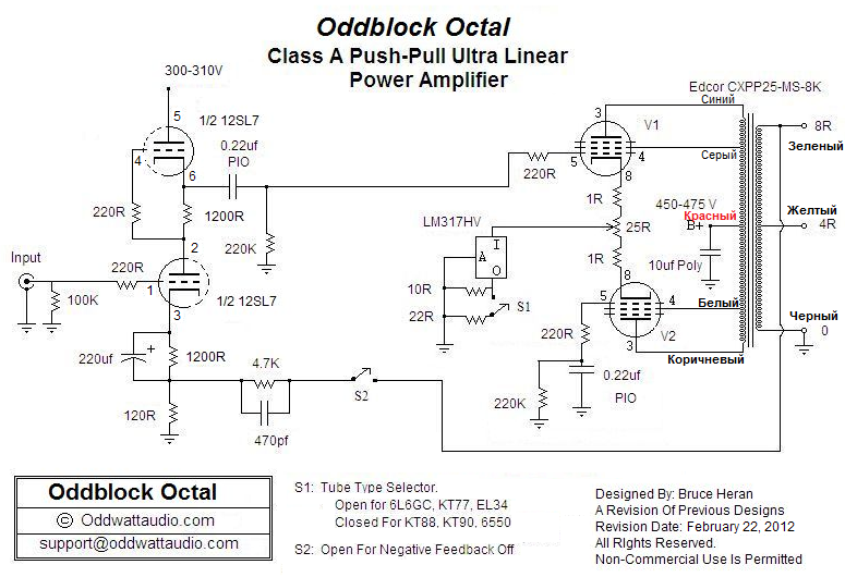

Я постараюсь сделать небольшие зарисовки по поводу выходного трансформатора.
Первая схема была взята отсюда. Вот что пишет Брюс по поводу выбора трансформатора:
" I already had Edcor output transformers from a project that didn't get built. Since transformers are a major cost, I didn't want to buy more."
"For those of you who are observant, you probably noticed that I used 8K output transformers. The load required by the tubes is closer to 4K. The way this works is that the transformers are rated at an 8 ohm load on the 8 ohm tap. If you use the 16 ohm tap for 8 ohm loads, the reflected impedance to the output tubes is cut in half. If you don't believe it check the math on how to calculate the output transformer load resistance. Likewise the 8 ohm tap can be used for 4 ohm loads."
"UPDATE - December 2012
Regarding the audio output transformer load. In this project the B+ is lower (350V) and the KT77 tubes seemed to work better into an effective 4k output load by using the taps as noted in the schematic. However with the higher B+ this has turned out not the case. and the Oddwatt 225 amplifiers are not as good as the Oddblock tube amplifiers."
"The KT77s (JJ) and 6L6GCs (JJ) seem to work quite well at 250 to 350 VDC into either 4 or 8K loads. The Gold Lions seem to work best (testing still going on here) at 475 B+ into 8k." отсюда На этой же странице ниже: "For the bigger Oddwatt style amps (6L6 and up)...Use an 8K load"
"On the use of KT88s in with a 3.5K or similar trannie. In this design they work far better in a higher impedance. About 7K would be the choice but I use 8K and they are fine. I run them at 90ma each at 450B+. For a class AB amp your transformer would be fine but as these are class A the higher impedance works better. Use 6.6K for KT120s at 120ma each if you want to go big. The 8K value works well for KT77s and EL34s." отсюда
"i want 8k primaries with the 450v setup, so am i supposed to hook the 8ohm to the 8ohm tap, or am i supposed to hook the 8ohm to the 16ohm tap like on the oddwatt 225 tube amp?" здесь
"Use the outputs 8K into 8 ohms like they are designed. Over time I have discovered that most of the possible tubes work well there (the KT120s do not). I probably should update the previous project." ответ здесь

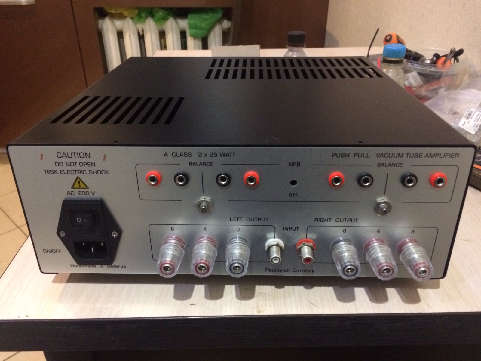

Собрал я свой OddBlock.Питание выхода 350В,драйвер 215В,ток ламп выхода 61мА,сбалансировать удалось.Фона нет от слова совсем,Лампы временно 6н9с и 6п3с,новые 62 и 64 год,прошлого века.Делаю под МЭЛЗ 6н9с и 6L6GC.И вот такая незадача вышла,на громкости ближе к максимуму,начинаються искажения,клиппинг 100%.Пока не ставил изделие на генератор и осциллограф,но какова может быть причина.Еще: ООС что в схеме,ну очень режет по всему диапазону на слух.Да и фото трансов что мотал мне человек.Raa 5к-выход 0-4-8 ом.
Неужели как писал Брюс,надо было делать Raa-8k?

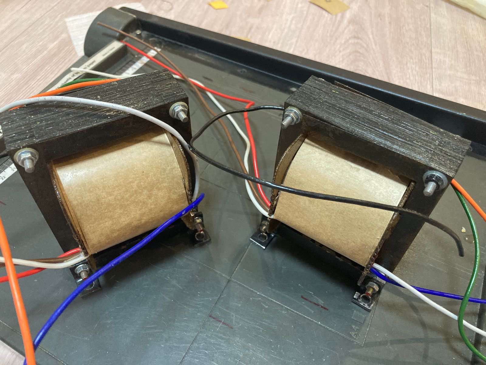

Пока разбираюсь,мне изготовитель тр-ров прислал цветовую раскладку,как подключить его изделия.И в даный момент я думаю он перепутал верх и низ на первичке.Задал ему вопрос об этом,но он молчит пока.

wowdima, какие выходные лампы? Работает ли источник тока в катодах выходных ламп? На чём сделан источник тока?
ООС должна начинать действовать примерно с 40кГц, такое поведение, как у Вас, может указывать на наличие самовозбуждения (т.е., у Вас получилась не ООС, а ПОС).

На выходе сейчас 6П3С,думаю если я токи выставил 62 мА,то источник тока в катодах работает.Он сделан на LM317.ПОС думаю,от того что неправильно мне изготовитель тр-ров дал раскладку.Самое счас обидное,я по его указке,провода обрезал,и в схему приютил как удобнее.

wowdima, ничего страшного, усилитель вполне работает без ООС.
Имейте в виду, что "чистые" LM317 (без суффикса HV) держат 37В, поэтому измерьте напряжение на катодах. Возможно клиппинг происходит из-за защиты по напряжению, если сигнал на катоде превышает некоторое напряжение.
Возможно 6П3С не может работать в таком режиме (нужно меньше или больше тока).

не не замыкают,проверял,да и не регулировали б они.А так все регулируеться,влево-вправо.И на резисторе 10ом напруга 1.25 есть.Просто мало мощи,низ слабый,а даешь больше начинает искажать.Буду завтра первичку перекидывать,верх-низ,скорее всего он попутал раскладку.

Если собрано по схеме из первого сообщения в теме (т.е., сигнальная земля и корпус соединены через 100Ом), то работа источника тока могла легко сохраниться. По сути - это параллельно включенные к токозадающему резистору LM317, который в данном случае будет 10 || 10 || 100 (кстати, можно проверить мультиметром на всякий случай, сколько там показывает сопротивление). По фен-шую так делать нельзя из-за разброса параметров микросхем, но на практике это часто срабатывает, особенно, если микросхемы из одной партии.
Регулировка баланса осуществляется резистором и будет работать даже если сам источник тока не работает, другое дело - величина тока, очень маловероятно, что оно совпало с выставленными значениями.
Я предлагаю начать с тестирования без ООС, в этом варианте нет разницы в фазе включения первичной обмотки (за исключением случая, когда напутаны анодные и экранные выводы).
Надо проверить не просаживается ли анодное на мощности, когда начинается клиппирование (хотя бы мультиметром) и не изменяется ли напряжение на токозадающем резистор LM317.
Можно попробовать подключить к другому выводу (4/8 Ом).

Победил я проблему.Поменял первичку верх-низ(по схеме).Всё четко работает.Как вы писали,что нет разницы в фазе включения первичной обмотки без ООС,не соглашусь.Если правильно подключено выход один на земле,другие 4 и 8 ом,если первичку неправильно включить,выход будет наоборот,по итогу:8ом на земле,4 непонятно где,а земля вместо 8ом.Токи 62мА сбалансированы,теперь на очереди квартет 6L6GC.
